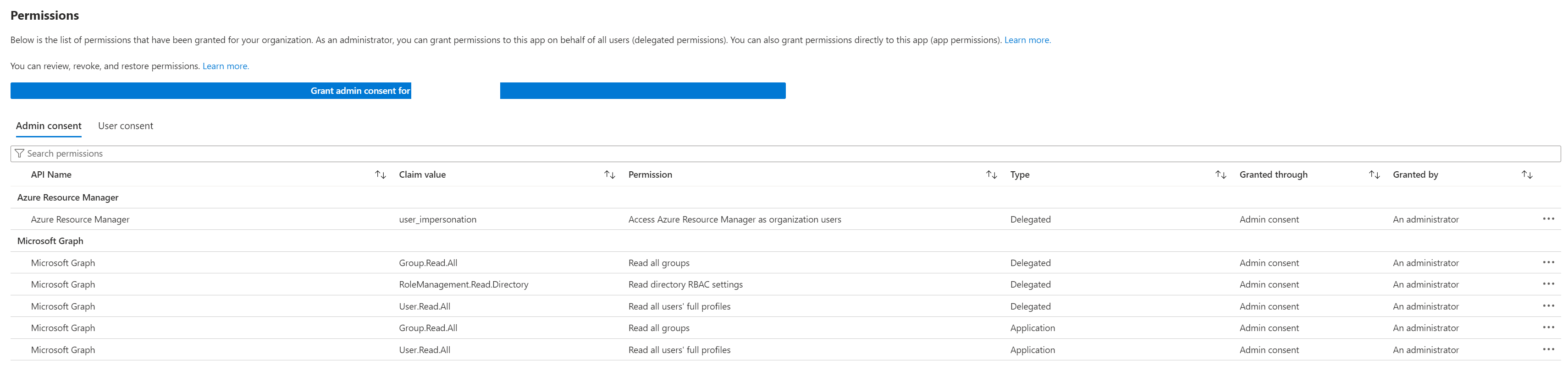

  3. Navigate to the Azure Portal -> Entra ID -> Enterprise Applications -> "CloudHealth" -> Permissions
  4. Confirm that the following permissions are in place:
  5. If any of these permissions are missing, it may be necessary to unconfigure AuthHub Azure AD and then perform the configuration again. This will deploy an updated copy of the Enterprise Application that has the required permissions in order to support users with more than 100 groups.
