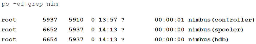

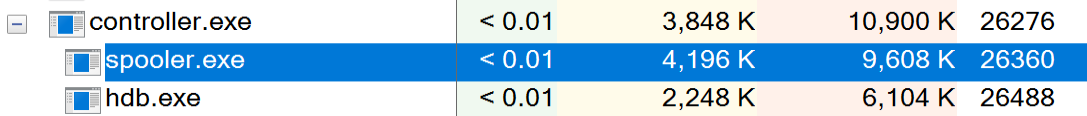

  • There are 2 spooler services running

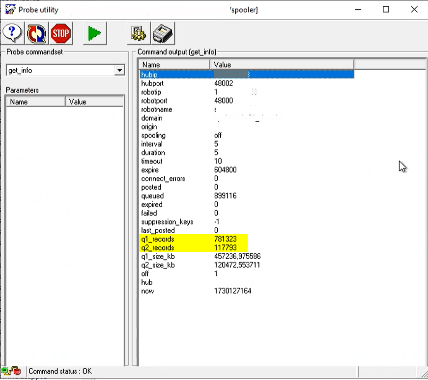

Checked the spooler probe via IM on the robot using the probe utility (via Ctrl-P) -> and ran the spooler get_info callback to see if messages were flowing efficiently on each robot.
We added a new key into the spooler configuration:
   bulk_transfer = <value>
For the first robot/system we set the value to 1500 (number of messages)
on the 2nd robot having the same spooler issue, we set it to 500.
So essentially, we added this new key-> bulk_transfer and set it to a value (number of messages) so that the q1 and q2 records would decrease and and not continue to build and use up the disk space caused by the queues not processing quickly enough due to the message traffic. In this case it was due to the oracle_monitor process. We could see a lot of messages from the oracle probe (oracle_monitor probe process) using Tools->DrNimBUS.
Once we made a few adjustments to the value for bulk_transfer we used the spooler probe utility and continued checking the number of q1 and q2 messages and they were processing very well and even emptying down to 0. So in summary, the incoming rate of the QOS was more than the outgoing rate. Adding and setting bulk_transfer key in spooler.cfg to 1500 on one robot and 500 on another robot resolved the issue.
