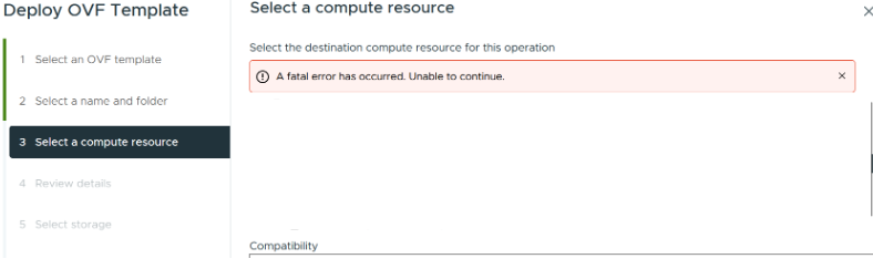

  • The error 'A fatal error has occurred. Unable to Continue' appears in the Deploy OVF Template wizard within the vSphere Client.
  • This error also appears when the Content Library service is not running.
  • The Content Library uses the vCenter FQDN in the file URL (e.g., https://vCenterFQDN:443/cls/data/################/descriptor.ovf) to download the descriptor.ovf, which is logged in the vCenter Server at /var/log/vmware/content-library/cls.log.
