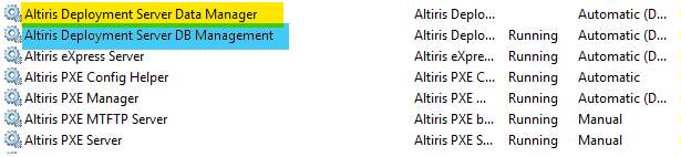

However, the main issue here is that this service is actually a legacy / obsolete one. It shouldn't be present and running in the first place. This service shouldn't be confused with "Altiris Deployment Server DB Management" service found at "...\Program Files (x86)\Altiris\eXpress\Deployment Server\dbmanager.exe". These were two different and services as seen here:

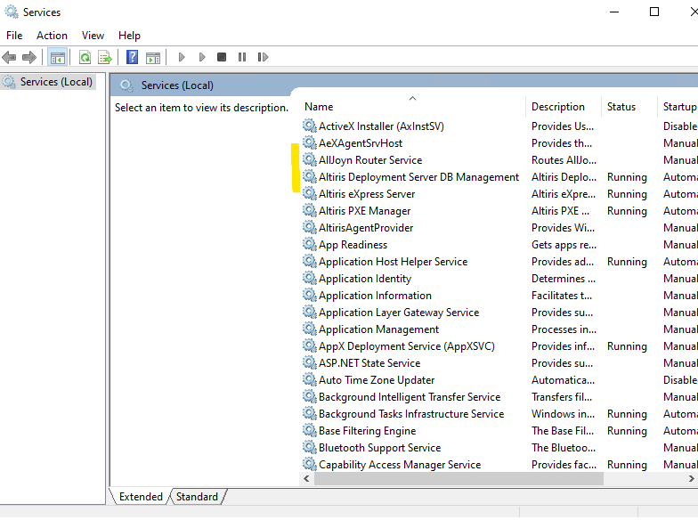

In a standard GSS installation, the "Altiris Deployment Server Data Manager" service is not present as shown here:
