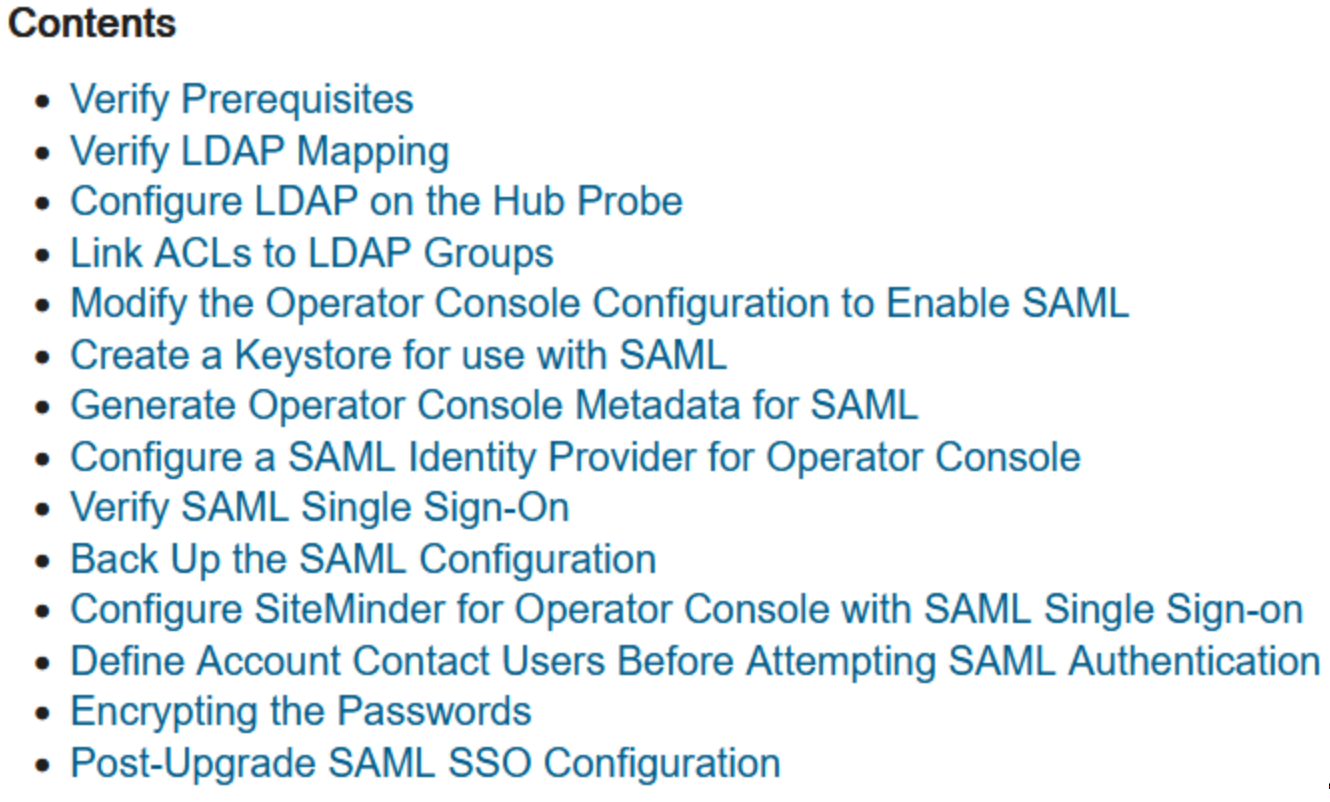

We just finished setting up LDAP and now we want to enable SAML. LDAP is non-SSL so SAML can be non-SSL as well.
The documentation for SAML is very extensive (for example there are several topics AFTER verifying if it's working) and needs a lot of information entered.
In contrast, we already configured SAML for Spectrum and only needed a URL there instead of all these details like Entity ID so we are a bit lost.
Here are some questions:
1. In general, which of these points need to be done for a very simple SAML integration without SSL?
2. Is Siteminder actually required? We are not using siteminder at the moment.
    Can all steps mentioning Siteminder be skipped in this case or do we need to do them with our identity provider instead?
3. Is the keystore actually needed if we don't need SSL?
4. The keystore being talked about in "Modify the Operator Console Configuration to Enable SAML" is the one from "Create a Keystore for use with SAML" correct?
5. How do we import the metadata to our identity provider? It should be Active Directory.
  • DX UIM 20.4 CU10
  • SAML
  • Guidance and clarification
    Answer: It is recommended to go through and follow all of the steps provided in the document.
    Answer: User can use any other IDP or Identity provider (supporting SAML 2.0 protocol) and steps need to be followed according to that IDP.
    Answer: Keystore is needed if SSL is mandatory (for example in ADFS, SSL is mandatory, so keystore is required)
    Answer: Yes, correct.
    Answer: In this document, we have shared the steps to create the metadata (xml file) which is required to be deployed on the IDP server.
    How to import could vary from IDP to IDP, so this should be discussed with an IDP admin / SME  or follow the docs of a particular IDP.
