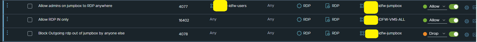

    • For example see the screenshot below:
      • The IDFW rule "Allow Admins on Jumpbox to RDP anywhere" is applied only to the Source VM's where it is needed.   It is normally not set to DFW as that is too broad.
      • The rule "Allow RDP IN Only" is applied to the destination VM"s and allows RDP traffic in the IN direction only.
      • The last rule block all RDP connections from the Source VM's, which blocks all non-admin RDP attempts.
