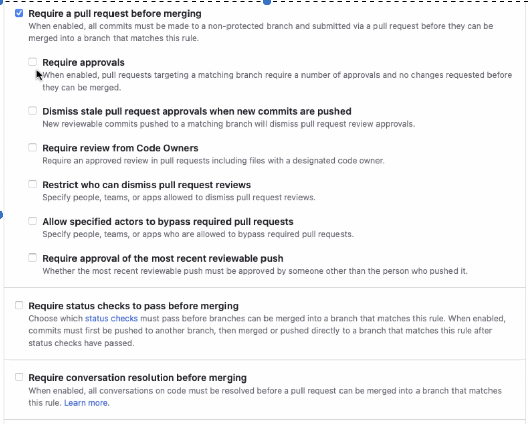

The main requirement for Endevor Bridge for Git is that the mapping owner is able to push to synchronized branches.
You can set up rules for other users and DO NOT enable the checkbox:
"DO NOT allows bypassing the above settings"
The above settings will apply to administrators and custom roles with the "bypass branch protections" permission.
That way you can have the mapping owners be administrators of the github repositories or have a custom role that allows them to bypass the branch protections rule.
You can also experiment with "Require conversation resolution before merging"
