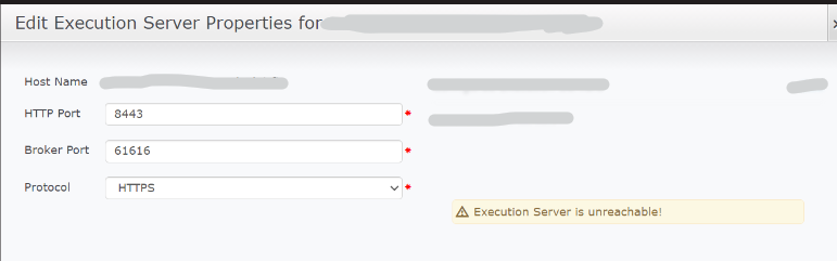

One NES (Nolio Execution Server) becomes unreachable from NAC
NAC could ping NES without problem.
Ports TCP 61616 8080 and 8443 are not opened in both direction.
in case of SSL configuration NES Certificate is valid and correctly configured in NES keystore and NAC trustore.
In NAC log nolio_dm_all.log following message appears several times :
2024-09-17T14:07:35.095+03:00 [ExecutionServerStatusTask-98] INFO  (com.nolio.platform.server.dataservices.services.execmng.CheckExecutionConnectivityImpl:128) - ES [nes_name] is unreachable.
Release Automation - All Versions
One possible cause of this problem is that time on NES and/or NAC is not correct.
Example :
NES has the correct time but NAC has current time + 15 minutes
Check the current time on NAC and NES. If there is a big difference (>5 minutes) correct the time on the NES or NAC.
Check the NTP service and NTP configuration.
