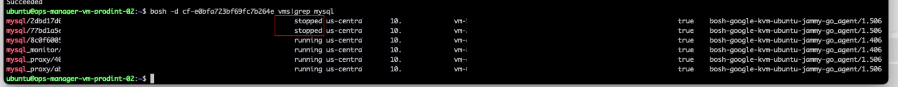

Also when you check vm state using bosh vms the MySQL is in a stopped state:
