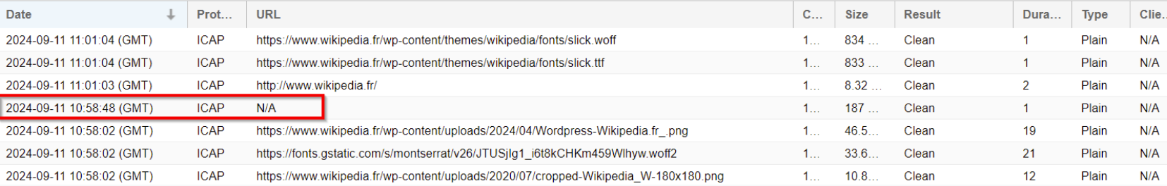

Historical Connection field is "N/A"
Article ID: 377087
ISG Content Analysis CAS-S200 CAS-S200-A1 CAS-S400 CAS-S500 CAS-VA
URL field in CAS Historical Connections is "N/A":
  • Content Analysis
One of the examples when this may occur is integration with F5 Load Balancer.
F5 Load Balancer performs health checks usually by sending simple HTTP GET requests.
URL is not recognized and results in "N/A"
  • Can be ignored
