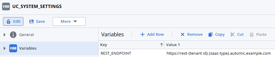

    This was sent in the initial email and should have a URL like https://rest-[tenant_id].example.com
                This can also be found in Client 0 - UC_SYSTEM_SETTINGS - REST_ENDPOINT

                This might be found in client 0 -> UC_SYSTEM_SETTINGS - REST_ENDPOINT, the same as in SaaS above
