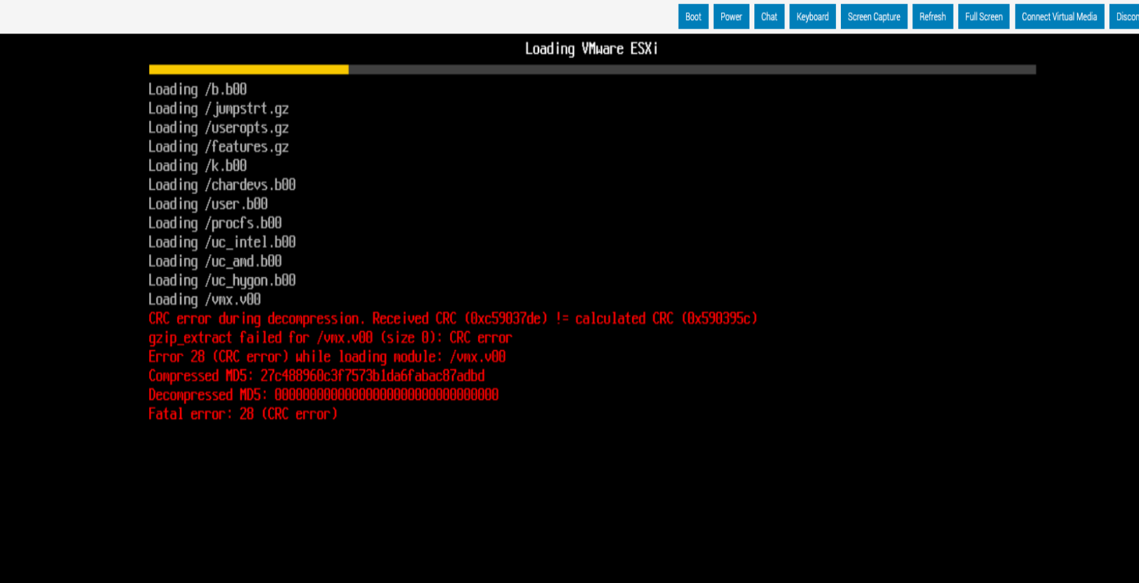

ESXi host fails while booting up with Fatal Error: 28 (CRC error).
 CRC error during decompression.
Error: 28 (CRC error) while loading module: /vmx.v00
Fatal error: 28 (CRC error)
As seen from host DCUI screenshot:
VMware vSphere ESXi
The CRC error during decompression while booting VMware ESXi typically results from data corruption due to:
  • Bad bootable media (like a faulty SD card, USB memory stick, failing SSD or incorrectly burned DVD).
  • Network issues during the ISO download, leading to incomplete or corrupt files.
