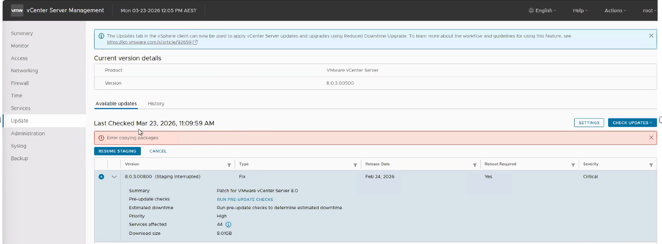

/var/log/vmware/applmgmt/PatchRunner.log:[YYYY-MM-DDT HH:MM:SS,927] Downloading RPM vmware-eam-7.0.3.02000-13507391.x86_64.rpm[YYYY-MM-DDT HH:MM:SS,934] Downloading RPM vmware-identity-sts-7.0.3.27000-13282826.noarch.rpm [YYYY-MM-DDT HH:MM:SS,565] Staging failed. Retry to resume from the current state. Or please collect the VC support bundle.
"requirements": { "questions": [], "rebootRequired": false, "requiredDiskSpace": { "/storage/core": 109.25557327270508, "/storage/seat": 362.4875
YYYY-MM-DDT HH:MM:SS.502Z INFO vmware_b2b.patching.phases.discoverer Check if there is enough storage for RPM installation
/var/log/vmware/applmgmt/update_microservice.log:
YYYY-MM-DDT HH:MM:SS,161 - 38623 - dbfunctions:: executeDML: 54 - DEBUG - Executing Query {UPDATE meta SET _isdownloaded = 1, _downloadendtime = DATETIME('now') WHERE _name = ? } with parameters ('vsphere-ui-7.0.3.01900-12788923.noarch.rpm',)
YYYY-MM-DDT HH:MM:SS,197 - 38623 - rpmfunctions:: isChecksumValid: 356 - ERROR - Checksum does not match, expected [c0d91f241d5f6843c372c8dc040f177cc378d2fad1d14581a51597764d3c773e], found [54d429a593d8f2a7f5b4feca734d442628d615b7ecb58f8836a8b4472f7b3a1d]
YYYY-MM-DDT HH:MM:SS,198 - 38623 - rpmfunctions:: downloadRpm: 642 - ERROR - Checksum failed for RPM {vsphere-ui-7.0.3.01900-12788923.noarch.rpm}
YYYY-MM-DDT HH:MM:SS,198 - 38623 - update_b2b:: _copyPackages:1030 - ERROR - Exception: name 'dbsqlstatements' is not defined
VMware vCenter Server
This failure occurs when the checksum validation of the ISO fails due to an incorrect SHA checksum, or when there is insufficient storage space on critical appliance partitions (e.g., /storage/core or /storage/seat).
To resolve this issue, the underlying space or checksum problems must be validated before resetting the patching environment.
Phase 1: Environment Validation
Verify the available space within the vCenter Server Appliance using the command: df -h. If any appliance partition is found to be running out of space, it must be expanded or cleared.
Verify the integrity of the downloaded ISO file by validating its SHA256 sum and comparing it against the published sum in the release notes or sha256sum.txt.
Phase 2: Clear the Staging Environment Once space and integrity are verified, the corrupted staging files must be purged.
(Note: Alternatively, the vCenter Server can be reverted to an offline snapshot taken prior to the patching attempt.)
Connect to the vCenter Server via SSH and log in as root.
Create a backup copy of the software update state file in a safe location: #cp /etc/applmgmt/appliance/software_update_state.conf /storage/core/software_update_state.conf.bak
Stop the appliance management service: #service-control --stop applmgmt
Remove the corrupted update files and database entries (Note: If a file or directory does not exist, proceed to the next command): #rm -r /storage/core/software-update/* #rm -rf /storage/updatemgr/software-* #rm /etc/applmgmt/appliance/software_update_state.conf #rm /storage/db/patching.db*
Start the appliance management service: #service-control --start applmgmt
Retry the patch update process.
