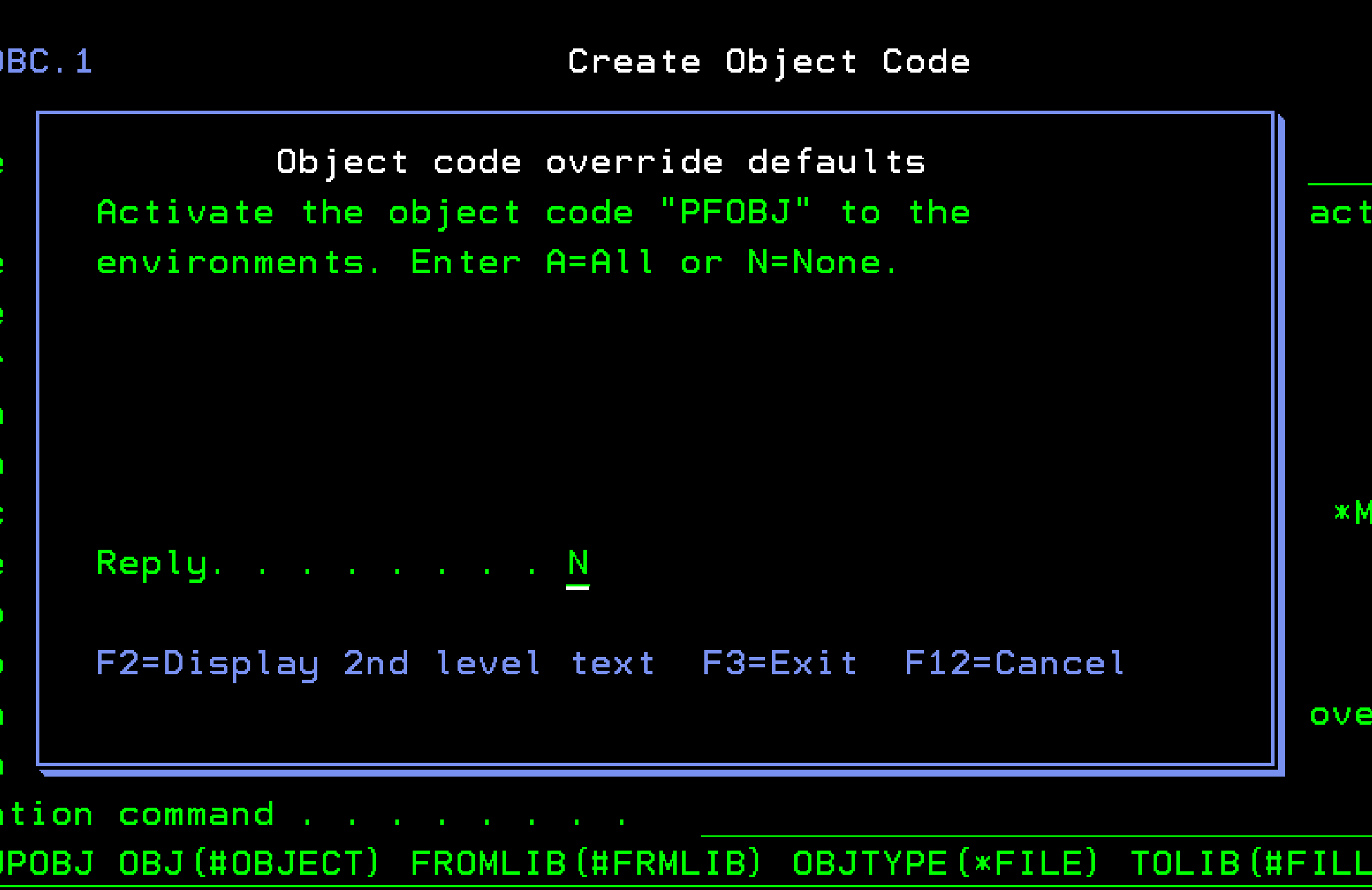

    Take option F6 to create a new object code. Enter the text as follows
    Press Enter. A pop up window opens up
    Enter A, to activate the object code for all the environments, and press ENTER. The object code should be added to the implementer and made available for all environments.
