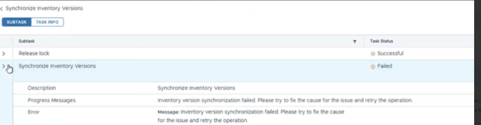

  • Unable to add a host in SDDC Manager -The process fails with the error: "Inventory version synchronization failed."

The 'Cluster Host Data Check' checks for discrepancies between the hosts present in the cluster in vCenter and in the SDDC Manager inventory. A mismatch between the two causes a validation failure, blocking the operation from proceeding.
Follow one of the two workarounds below:
Option 1:
Remove the hosts with the error state using the SDDC UI to synchronize the SDDC and vCenter inventories.
Option 2:
Disable the guardrails:
  1. Update the file /etc/vmware/vcf/domainmanager/application-prod.properties with following value:
    vcf.skip.dayn.guardrails=true
  2. Restart the domainmanager service:
    systemctl restart domainmanager
  3. Retry the workflow.
Note: It is recommended to re-enable this flag once the workflow is successful.
Updating the application-prod.properties file to skip the guardrail is a last resort and should only be done if none of the steps before have resolved the issue.
