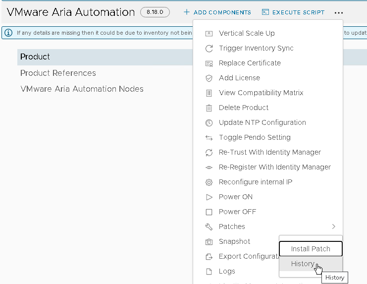

You can check the patches in VMware Aria Suite Lifecycle UI, open the Environment >> expand the Patches >> expand History
