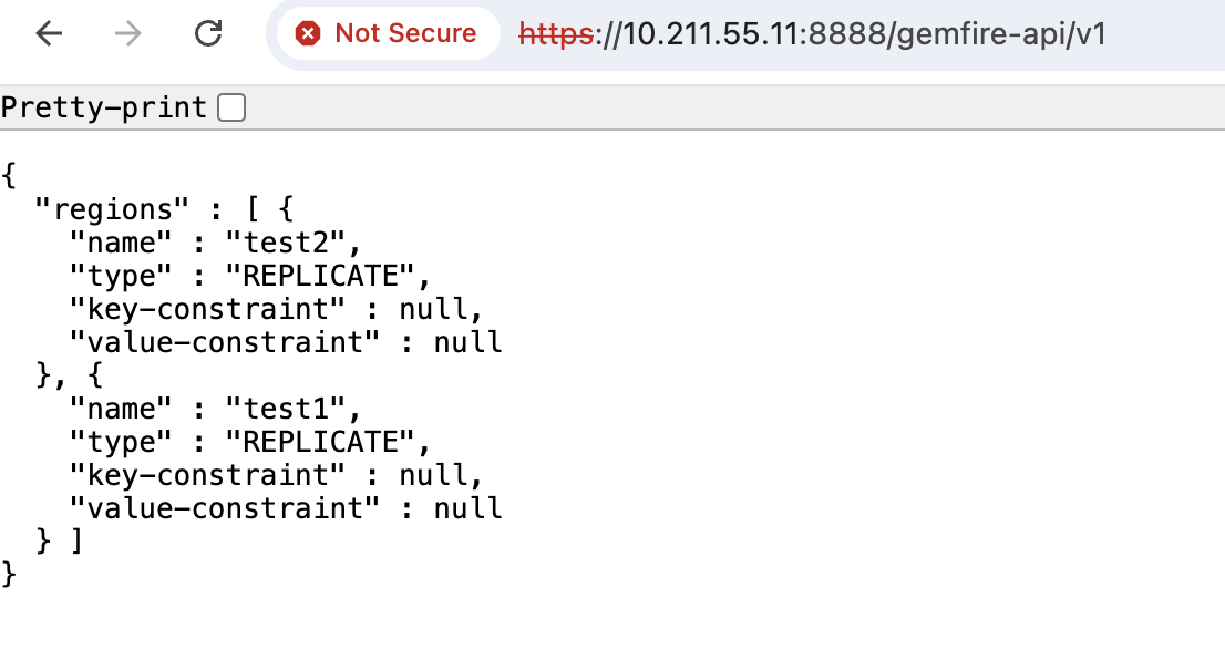

4. Put the address in the browser to access
https://10.211.55.11:8888/gemfire-api/v1
10.211.55.11 is the ip address of the Gemfire server.
