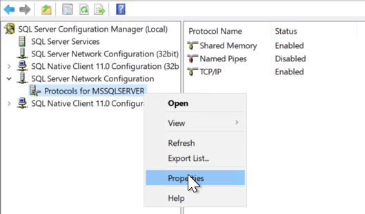

  • Open SQL Configuration Manager
  • locate and expand 'SQL Server Network Configuration'
  • right-click "Protocols for (INSTANCENAME)" and select Properties
  • check the value of "Force Encryption"

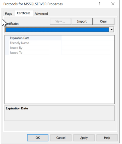

  • If this is set to 'Yes', check whether a certificate is enabled in the 'Certificate' tab.  The following screenshot shows no certificate enabled:
With this combination of settings, data_engine will still connect to the database without using TLS, but CABI will fail.
