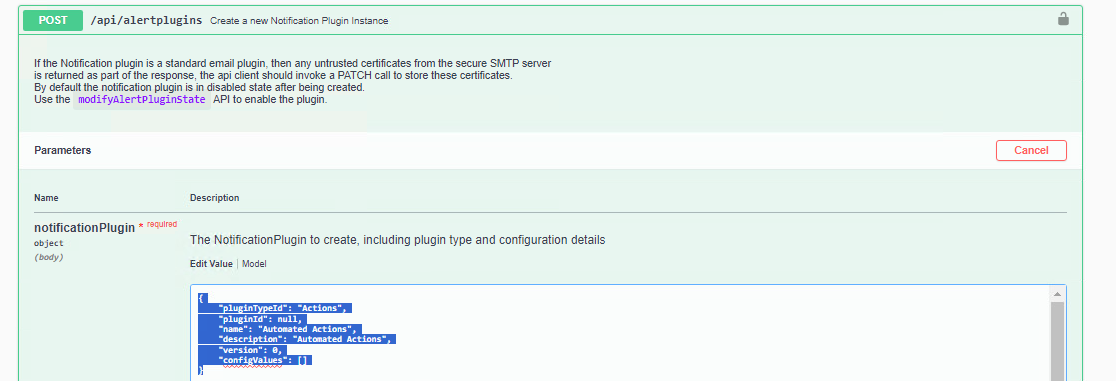

  7. Create/install the plugin using the following POST call:
    POST /api/alertplugins
    with the body of the POST set to:
        "pluginTypeId": "Actions",
        "pluginId": null,
        "name": "Automated Actions",
        "description": "Automated Actions",
        "version": 0,
        "configValues": []
    Click the Execute button.
