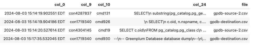

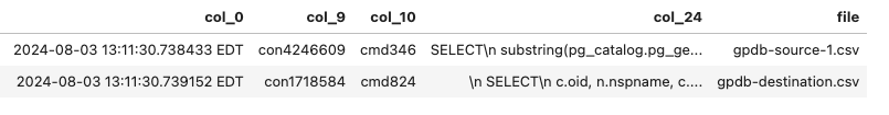

Taking one example view ("sample_vw") and focusing the comparison using GPCOPY log against the same view between schema_1 and schema_2, we can see "schema_2.sample_vw" unexplainably consumed significantly longer than "schema_1.sample_vw"
20240803:13:11:30 gpcopy:gpadmin:....:066553-[INFO]:-[Worker 5] Start copying table "sample_db"."schema_1"."sample_vw" => "sample_db"."schema_1"."sample_vw"
20240803:13:11:30 gpcopy:gpadmin:....:066553-[INFO]:-[Worker 5] [Progress: (0/1) DBs, (614/1274) tables done] Finished copying table "sample_db"."schema_1"."sample_vw" => "sample_db"."schema_1"."sample_vw"
20240803:15:14:19 gpcopy:gpadmin:....:050669-[INFO]:-[Worker 9] Start copying table "sample_db"."schema_2"."sample_vw" => "sample_db"."schema_2"."sample_vw"
20240803:15:17:35 gpcopy:gpadmin:....:050669-[INFO]:-[Worker 9] [Progress: (0/1) DBs, (620/1024) tables done] Finished copying table "sample_db"."schema_2"."sample_vw" => "sample_db"."schema_2"."sample_vw"

sample_db.schema_2 sample_vw 196.0 2024-08-03 15:14:19 2024-08-03 15:17:35
sample_db.schema_1 sample_vw 0.0 2024-08-03 13:11:30 2024-08-03 13:11:30
In taking the "schema_2.sample_vw" example above, analyzing pg_logs confirms the cause of the long elapsed time (196 second) is: DDL recreation is required on the target, hence execution of the COPY requires:
  1. Running pg_dump on the source cluster.
  2. Then re-creating the DDL on the target cluster using the generated Database dump.
For schema_1, "sample_vw" does not require creating DDL on the destination host, and so is the case for majority of the schema tables, resulting in less total elapsed time.
