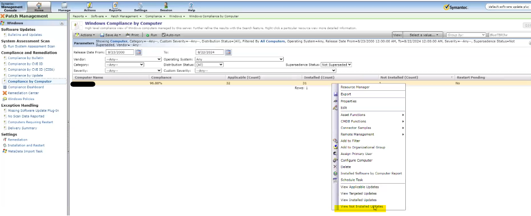

Ran the Compliance by Computer report setting the Release Date From parameter to the year 2000 and then reviewed the not installed updates (right-click an affected computer and choose this option) to see the missing updates. It was then found in this case that MS21-08-SSU-5005112 was missing. Then created a SW update distribution policy with this update, and after deploying this update, MS24-08-W10-5041578 then showed in the compliance report for the affected servers, and were then able to deploy and install the update.

  2. Look at the SMP Console and under "Compliance by Computer" report, find that this affected Windows Server under "View Not Installed Updates" had some Critical patches missing (we set the "Release Date From: 8/23/2000" and changed the "Supersedence Status: Not Superseded". In this case, it was missing one critical update: MS21-08-SSU-5005112.

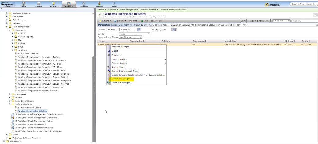

  3. Look at the "Windows Superseded Bulletins" report for that MS21-08-SSU-5005112 (in this case, it is not one that is superseded by another one). So, it needs to be distributed to this Windows Server.
