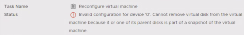

An error is encountered when attempting to remove a hard disk from a virtual machine.
The error indicates that one of the parent disks is included in a snapshot of the virtual machine.
  • Invalid configuration for device '0'. Cannot remove virtual disk from the virtual machine because it or one of its parent disks is part of a snapshot of the virtual machine
