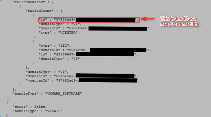

  2. List the upgrades from LCM to determine the ID of the failedDomains:
    • curl localhost/lcm/inventory/upgrades | json_pp
      Example output:

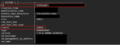

  3. Check the state of the VC from the SDDC DB:
    • Connect to the Platform DB
      • psql -h localhost -U postgres -d platform
    • Check the current state of the Inventory using the id from output above:
      • select * from vcenter where id='57452ad9-####-####-####-########';
        Example output:
