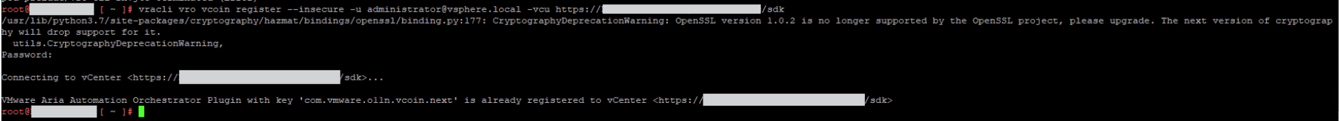

  • When trying to re-register the vcoin extension from orchestrator using vra cli command options, error noticed that the endpoint is already registered as an extension with a key:

      vracli vro vcoin list
    3. In the below example, we see 3 records actively listed as vCenter extensions
    4. Identify the records which may correspond to the endpoint under consideration (You may notice multiple records, if the registration was attempted from command line with different usernames - causing staleness due to multiple records)
    5. Clear out record(s) corresponding to the vCenter endpoint under consideration using the command:
      vracli vro vcoin unregister --force --insecure -u <username> -vcu https://<vcenter endpoint extension>/sdk
      You would be prompted for the password for the username used above
    6. Once successfully un-registered and all stale entries have been cleared out, if any, validate the vsphere web client that the Orchestrator extension is no longer visible.
    7. Register the vcenter server as an extension using the below command:
      vracli vro vcoin register --insecure -u <username> -vcu https://<vcenter endpoint extension>/sdk
