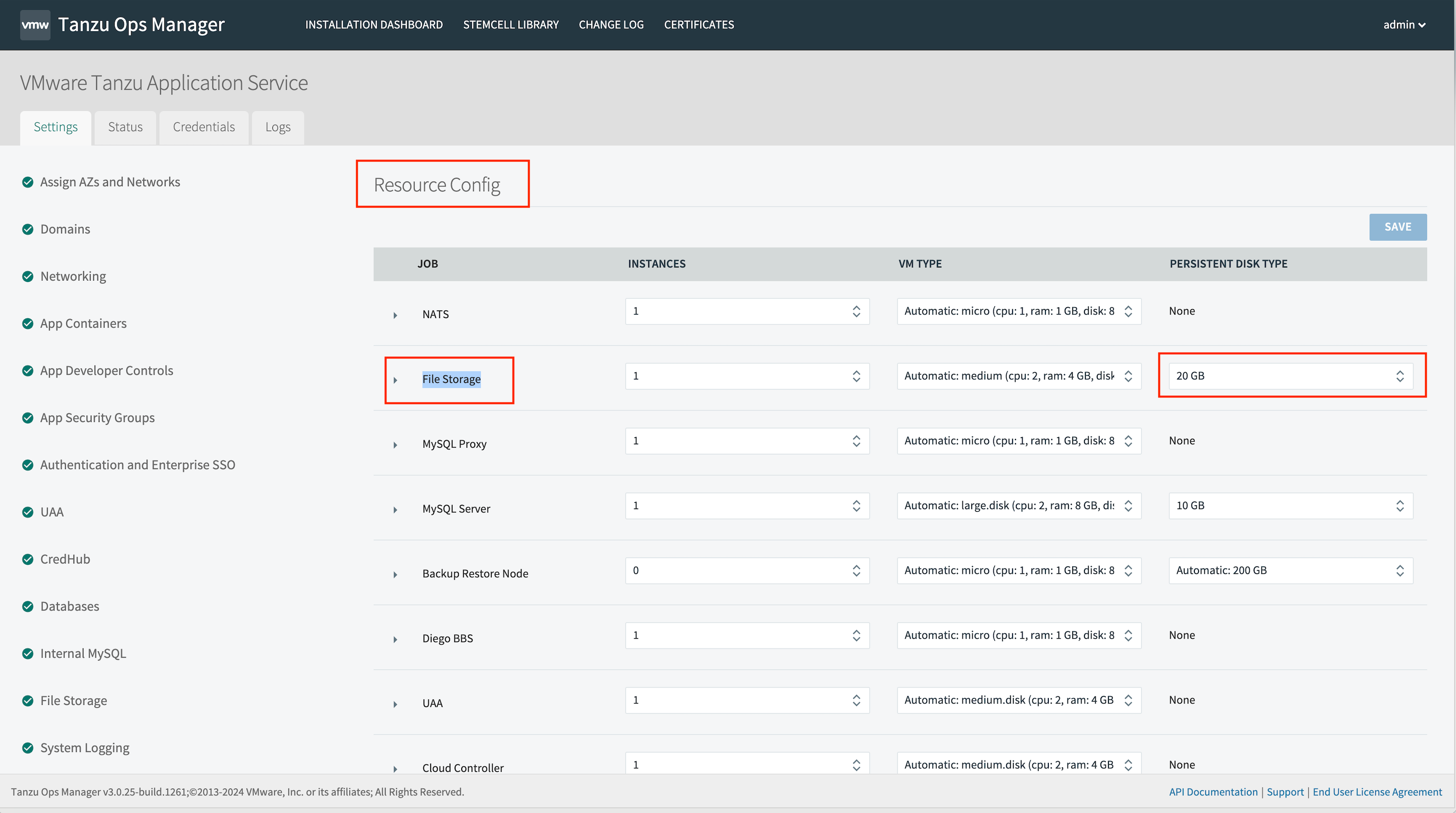

1. Per the documentation (Configure TAS - File Storage), set the maximum droplets and packages per application to be both 1 as seen in the image below. We can find this setting by clicking TAS tile > File Storage, and change the Maximum valid packages per app and Maximum staged droplets per app to 1 and click the save button.
NOTE: After clicking the save button, we would need to run an Apply Changes only on the TAS tile

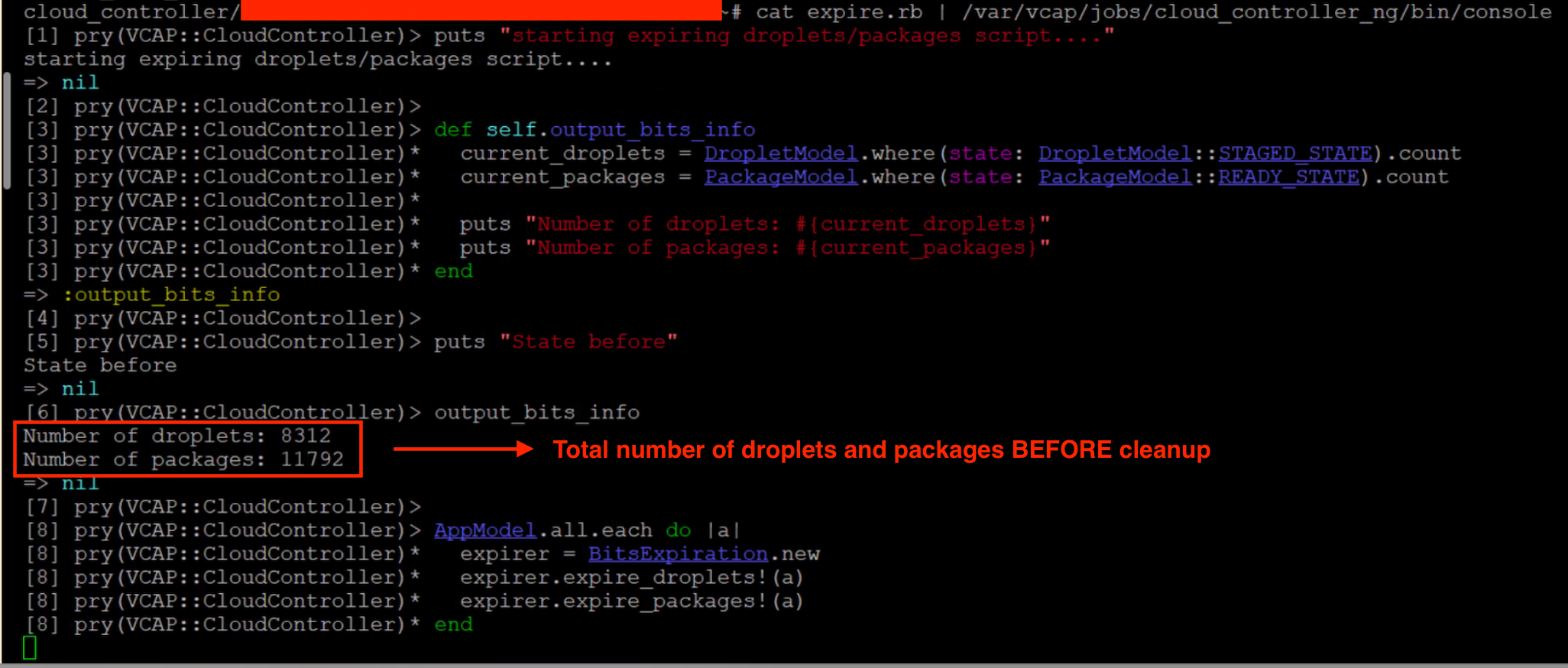

cat expire.rb | /var/vcap/jobs/cloud_controller_ng/bin/console
8. When running the script, we may get an output that looks like the image below. Notice the total number of droplets and packages printed out. In this case, we have a total droplets and packages count of 8,312 and 11,792. These totals are BEFORE the cleanup is actually run. If the issue is truly due to stale droplets and packages taking up disk space, the number of droplets and packages should decrease after the script is finished running.

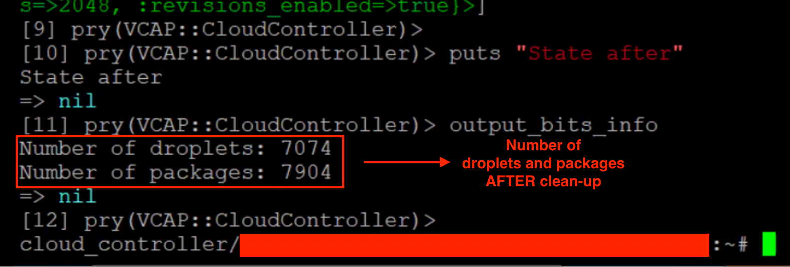

9. After the clean-up portion of the script runs and finishes, we may get output similar to whats in the image below. If you get a similar output, press the 'q' key to exit out of the script output:
10. After pressing the 'q' key, we get this output seen in the image below. We notice that the total number of droplets and app packages has decreased down to 7,074 and 7,904. From step 7, we recall that the total number of droplets and app packages were 8,312 and 11,792. Because the number of droplets and packages has decreased, it is likely that we had a fair number of stale droplets and app packages.
