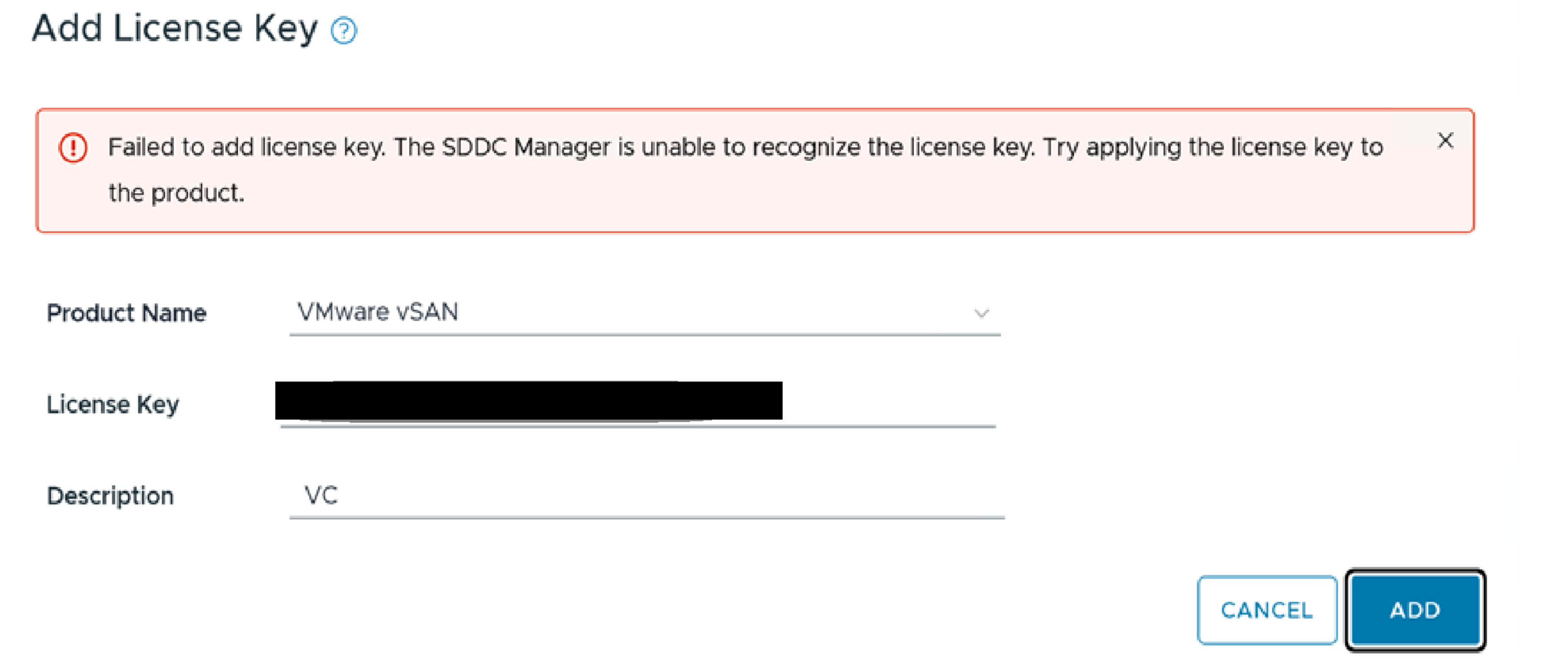

"The SDDC Manager is unable to recognize the license key" error when adding ESXi or vSAN or vCenter Server license on SDDC Manager
Article ID: 375046
VMware Cloud Foundation 5.x
  • There is "The SDDC Manager is unable to recognize the license key" error when adding ESXi or vSAN or vCenter Server license on SDDC Manager.
  • An error is observed on the SDDC Manager in the log file /var/log/vmware/vcf/operationmanager/operationmanager.log, as shown below:
    com.vmware.licensecheck.SerialNumException: Invalid serial number: no dormant license file corresponding to the serial number
VCF 5.2
SDDC Manager cannot decode the newer VCF license keys due to missing dormant license files (DLF).
