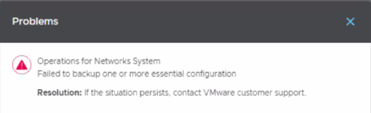

Aria Operations for Networks GUI shows System Infrastructure as Poor and error seen is Failed to backup one of more essential configuration
Article ID: 374541
VCF Operations for Networks
Aria Operations for Networks GUI shows System Infrastructure as Poor and error seen is "Failed to backup one of more essential configuration".
VMware Aria Operations for Networks 6.12
VMware Aria Operations for Networks 6.12.1
VMware Aria Operations for Networks 6.13
VMware Aria Operations for Networks 6.14
Backup Restore via CLI has been configured which has failed. Due to this the error message seen on Aria Operations for Networks GUI is expected.
To get rid of this error message delete the backup-restore backup created on Platform Node 1 appliance
1.Take a SSH/Putty session to Aria Operations for Networks Platform Node1 and login with username consoleuser.
2. Execute below commands
(cli) backup-restore backup --action status
Status: COMPLETED_FAILED
Last Updated TimeStamp: 2024-08-12-20.50.33
Backup File Name: vrni_backup-10000-###.##.###.##-2024-08-12-20.50.24.tar
Failed components: UPLOAD_BACKUP_FILE
(cli) backup-restore backup --action delete
BACKUP : Configuration successfully deleted
(cli)
3. Navigate back to Aria Operations for Networks GUI and the error message seen should clear and system Infrastructure shows as Health/Green.
