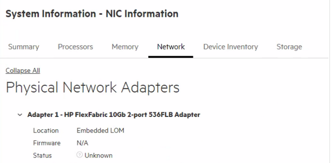

esxcfg-nics -l[root@esxi:~] esxcfg-nics -lName PCI Driver Link Speed Duplex MAC Address MTU Description
In the below screenshot, the status of the LOM is unknown, which is an indication of a hardware issue.
Example:
Involve the hardware vendor for further investigation.
