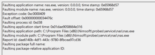

This causes an error in the NAS probe and the probe crashes.
The error message indicates the file or module is not found.
Exception code: 0xc0000409
Fault offset: 0x000000000034476c
