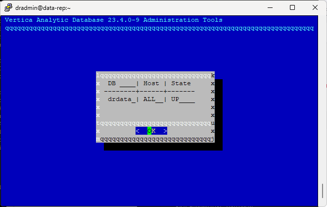

Performance Management 23.3.11 and higher
The script failed, after upgrading to version 11.1.1-24, and didn't do the subsequent upgrade to 23.4.0-9
Run the installer again:
dr_install.sh -p drinstall.properties
This should complete the upgrade, and bring the Vertica version up to 23.4.0-9
