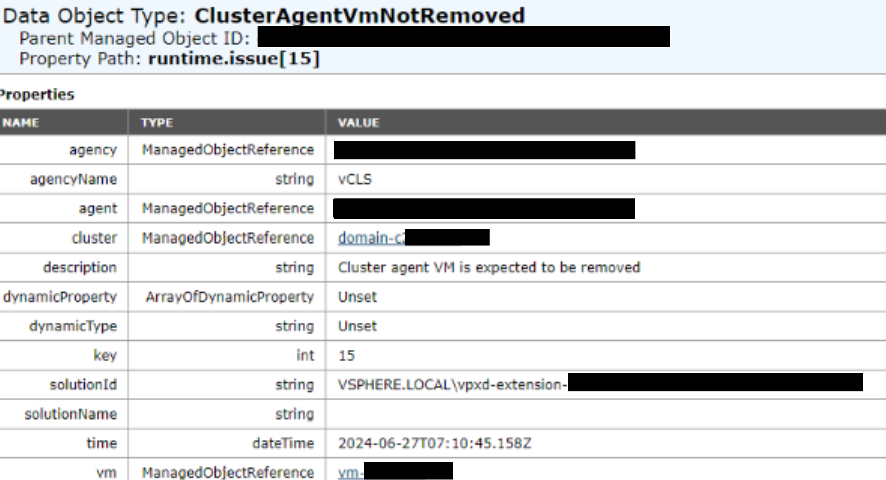

/var/log/vmware/eam/eam_api.log
YYYY-MM-DDTHH:MM:16.097Z |  INFO | vlsi | LocalizationFilter.java | 108 | API COMPLETE: ClusterVMAgency(ID:'Agency:########-####-####-####-XXXXXXXX:null').queryRuntime[opId=1181127682, sessionId=5393671A]. Result:
eam.EamObject.RuntimeInfo {
   issue = (eam.issue.Issue) [
      (eam.issue.cluster.agent.VmNotRemoved) {
         time = yyyy-mm-dd hh:mm:ss,158,
         description = <unset>,
         key = 15,
         agency = 'Agency:########-####-####-####-XXXXXXXX:null',
         solutionId = 'VSPHERE.LOCAL\vpxd-extension-########-####-####-####-YYYYYYY',
         agencyName = 'vCLS',
         solutionName = ' ',
         agent = 'Agent:########-####-####-####-AAAAAAA:null',
         cluster = 'ClusterComputeResource:domain-cnumber:########-####-####-####-ZZZZZZZZ',
         vm = 'VirtualMachine:vm-ID:########-####-####-####-ZZZZZZZZ',
   goalState = 'enabled',
   entity = 'Agency:########-####-####-####-XXXXXXXX:null',
   status = 'red',
