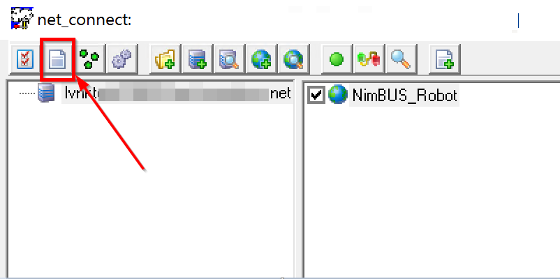

- Open the net_connect configuration GUI in Infrastructure Manager and click on the 'Message Pool Manager' icon.

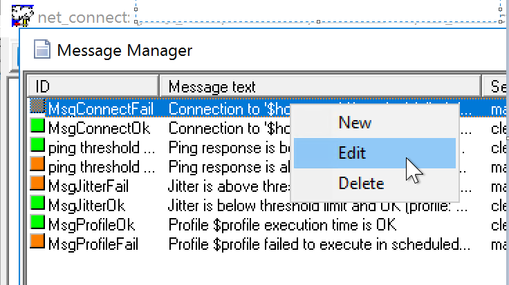

- From here, right click on any message and choose "Edit"
From there you can change any aspect of the message:
