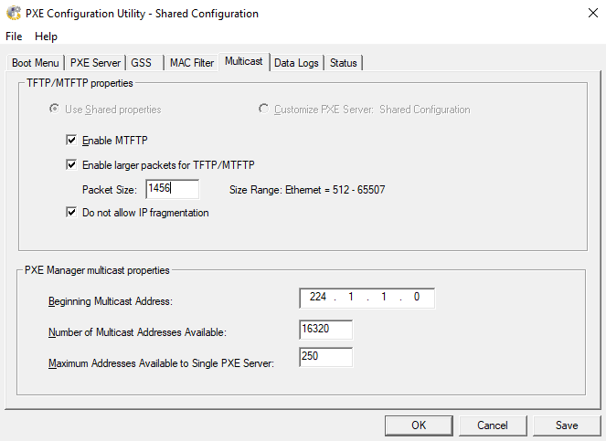

Open the PXE configuration utility from the Ghost Solution Suite Console and select the 'Multicast' tab. Under the option 'Enable larger packets for TFTP/MTFTP', modify the Packet Size value to 1456 and save these changes:
This value can be adjusted as low as 512 for older legacy network adapters, while a higher packet size should improve performance on network adapters that support it, but may need to be adjusted to a lower size to accommodate different hardware in your environment.
