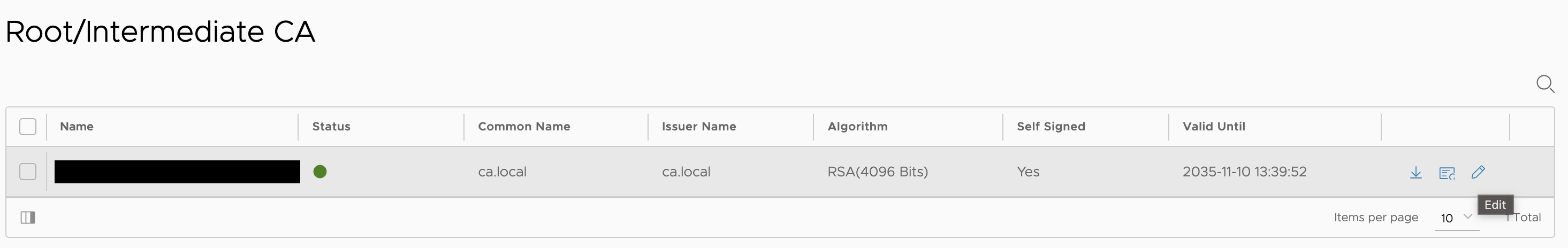

5. Import the Avi Cert - Intermediate or Root Certificate into NSX (Optional)
curl -ikv -u 'admin' --request POST \
  --url 'https://<nsx_ip>/policy/api/v1/trust-management/certificates/<name_for_cert>?action=import_trusted_ca' \
  --header 'Content-Type: application/json' \
  --data '{
    "pem_encoded": “<root_cert>”
To get the Intermediate or Root Certificate of Avi Controller Portal Certificate Navigate to Avi Controller UI > Templates > SSL/TLS Certificates > Root/Intermediate CA
5.1 Use the below API from Web Browser
https://controller-ip/api/sslkeyandcertificate/sslkeyandcertificate-UUID#Certificate-Name
5.2 Go to "certificate" section
5.3 Copy the entire Value of Certificate "-----BEGIN CERTIFICATE-----    -----END CERTIFICATE-----"
5.4 Replace the Certificate Details with command as per the step 4
"pem_encoded": “-----BEGIN CERTIFICATE----- -----END CERTIFICATE-----”
