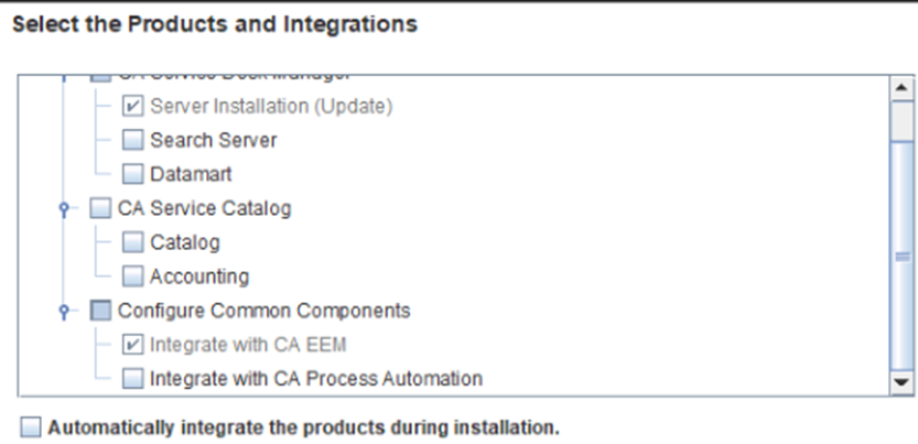

When Service Desk Manager (SDM) tries to be upgraded from 17.3 to 17.4 by using the install media, "CA SERVICE MANAGEMMENT SD PACKAGE 17.4 FOR WINDOWS (WITH CATALOG).iso", the "Integrate with CA EEM" option under the "Configure Common Components" is turned on and grayed out despite that the EEM has not been integrated with SDM.
  • EEM is on a different server from the SDM server and EEM is integrated with only Catalog and ITPAM.
  • Only SDM Background server is running on a server where the customer launches the upgrade process.
  • MDB is shared with other CA Service Management products, e.g. Catalog, Asset Portfolio Management, ITPAM, and etc.

The install media, "CA SERVICE MANAGEMENT SD PACKAGE 17.4 FOR WINDOWS (WITH CATALOG).iso" is not only specific for installing/upgrading SDM but also for integrating with EEM and ITPAM if their information is existing in MDB already. i.e. If the MDB has the details of EEM and ITPAM already, the option cannot be deselected. So, complete the 17.4 GA upgrade/install with EEM and ITPAM details, and turn off the integration options as per below after the upgrade/install is completed successfully.
