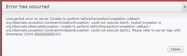

Deleting decommissioned servers from ROC UI - Agent Management tab failed with Unexpected error on server
[Unable to perform beforeTransactionCompletion].
The log shows error to insert into server_category_aud.
nolio_dm_all.log:
[https-jsse-nio-8443-exec-25] ERROR (org.hibernate.engine.jdbc.batch.internal.BatchingBatch:134)
- HHH000315: Exception executing batch [java.sql.BatchUpdateException: Cannot insert the value NULL into column 'id',
table 'NOLIO.dbo.server_category_aud'; column does not allow nulls. INSERT fails.], SQL: /* insert server_category_aud */
insert into server_category_aud (REVTYPE, REVEND, REV, server_id, category_id) values (?, ?, ?, ?, ?)
[https-jsse-nio-8443-exec-25] WARN  (org.hibernate.engine.jdbc.spi.SqlExceptionHelper:137) - SQL Error: 515, SQLState: 23000
