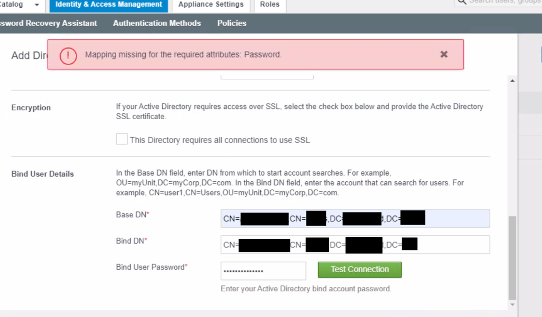

    'Mapping missing for the required attributes: xxx'
  • Example below shows attribute 'Password' as example:

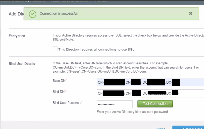

  • The entered binding DN and Base DN with password are valid as test connection is Successful:

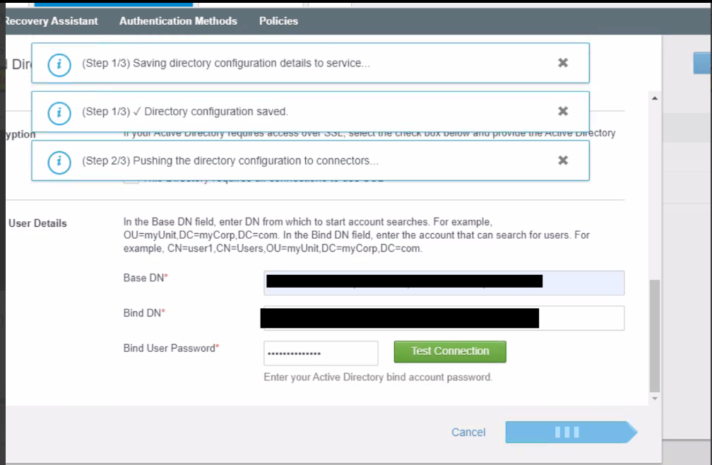

  • Upon trying to Save configurations, The Integration add passes through step 1 and 2 and fails at step 3:

  • This is caused if there are any binding attributes defined which are marked as 'Required', but may not be present on the AD users' attributes, thus causing the Sync/Add to fail while trying to map the attributes on both the end.
  • It may sometimes be noticed that the attribute being flagged for missing mapping, is not visible in the defined binding attributes when validating form the UI. However, when trying to add a new attribute with the same Name, would give error out the attribute creation saying 'Attribute names have to be unique'.
    Database modifications are required to resolve this issue, please open a Support Request with Broadcom Technical Support and note this Article ID (372964) in the problem description. For more information, see Creating and managing Broadcom support cases.
