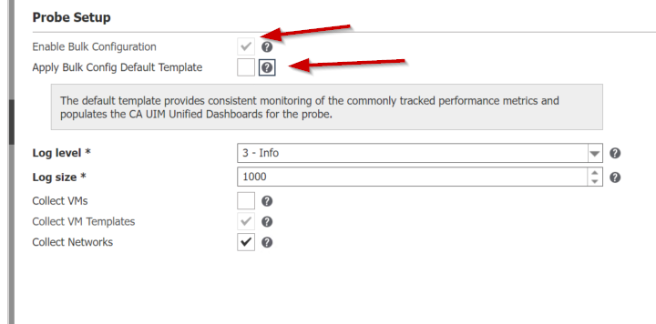

First you will need to deploy the new vmware probe to the new robot, and open the GUI in admin console and check/uncheck the boxes as follows -- don't add any profile/vcenter yet, change these boxes first, then click save-
1. Enable bulk configuration
2. Uncheck "apply bulk config default template" as you will be applying your own.

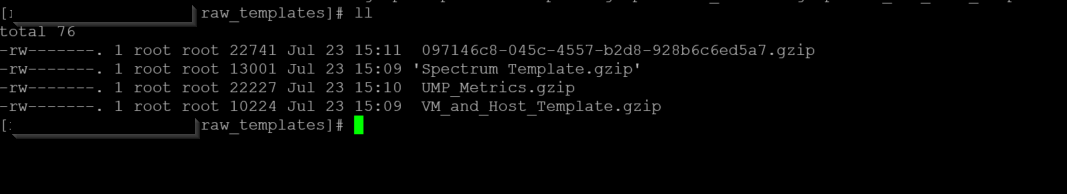

Locate the equivalent folder:  /opt/nimsoft/probes/application/vmware/bulk_config/raw_templates
in here you will see some .gzip files.  There will be the default templates, and then one or more with a long string for a name, as follows:
The one with the long string will be the one you created.  If there is more than one, you can make an update to the one you are interested in, then check the file date/timestamp and look for the one which is most recently updated.

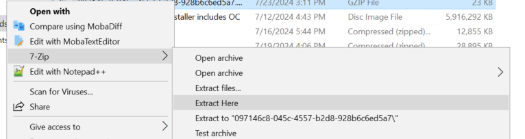

In Windows, you will need some utility like Winzip, 7-Zip, etc which can unzip .gzip files.  Extract the file:
After unzipping it you will have a file with the same filename but no extension:

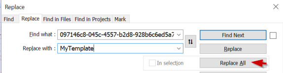

Do a search-and-replace for the original filename string and replace it with your chosen template name:

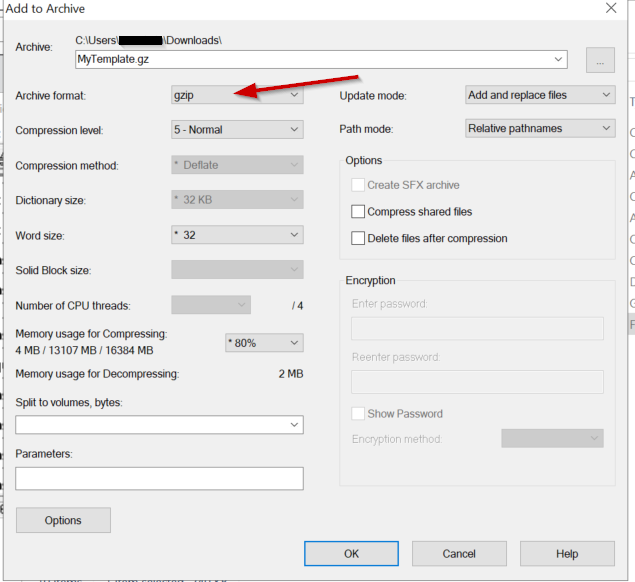

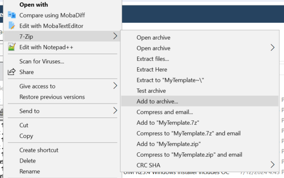

Save this file and add it to a new .gzip archive:
The default filename extension may show as .gz, so make sure to rename the file to .gzip.

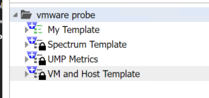

Now deactivate and activate the vmware probe where you copied this to.
Now, you will be able to see the new template in the vmware probe Template Editor.

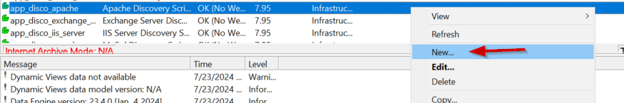

  1. in Infrastructure Manager navigate to the Archive
  2. right-click in the Archive window and select New...
  3. Fill out the package details as appropriate, then right-click on the empty Tab and click Add Section...

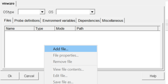

  5. Now inside the new section under Files, right-click and select Add File...

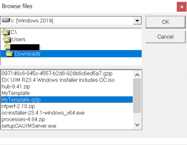

  6. click Browse and locate the .gzip file which you created above:
  7. For the "Path" variable, set it to:  probes/application/vmware/bulk_config/raw_templates
  8. Click OK, then OK again and the package will be saved in the Archive.
