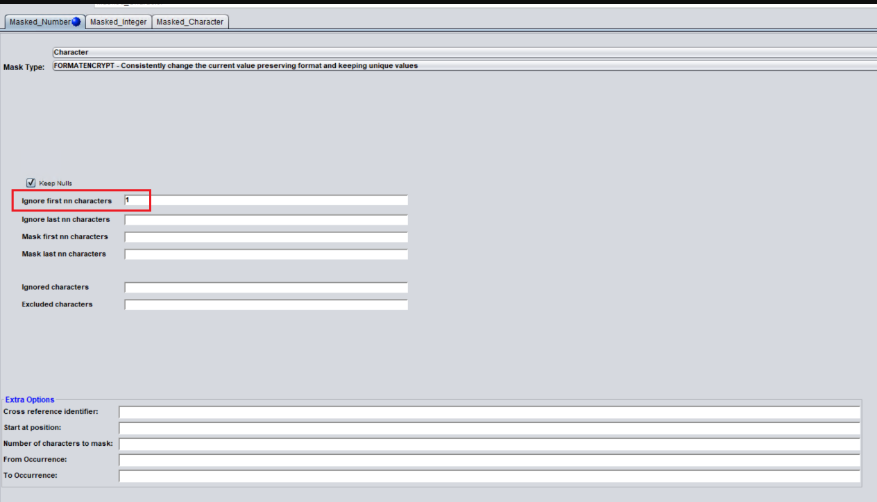

The proper solution is to ignore the first digit, when masking any numeric fields in the flat file, to ensure we get the same results as we are seeing in the database tables.
So when masking the flat file, where you have numeric data types, you need to set Parm1 (Ignore first nn characters) to 1.
