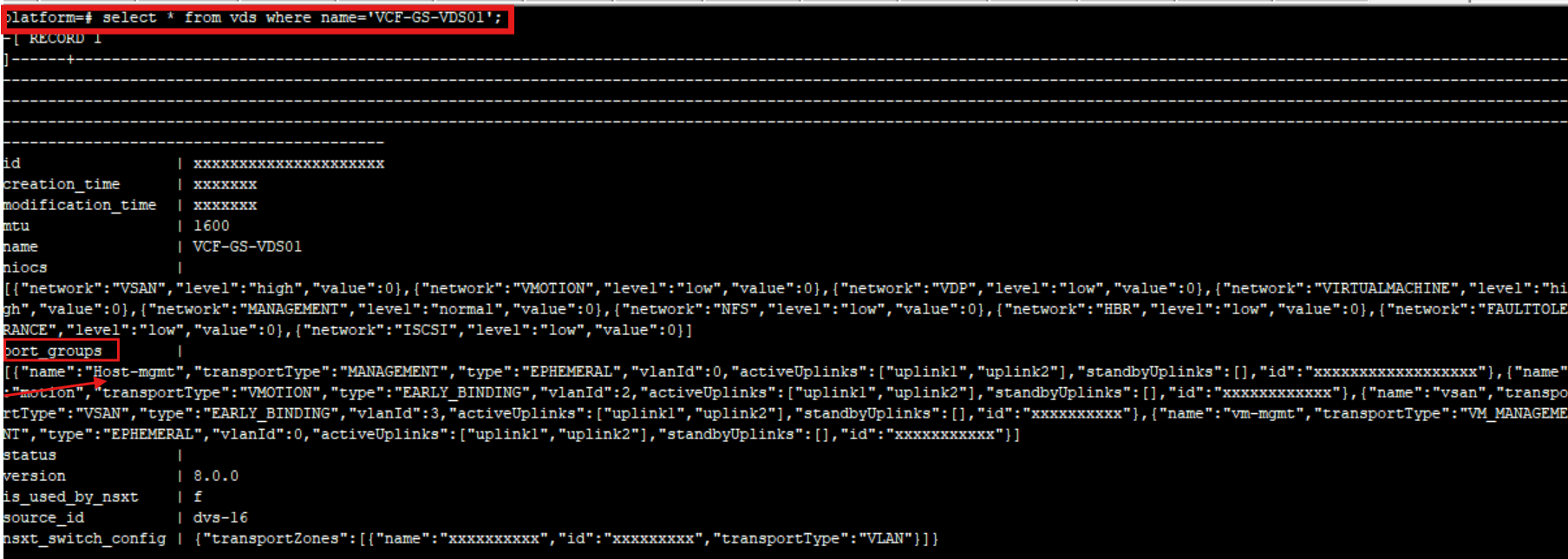

  1. Follow the below steps to gather the existing dvPortGroup in SDDC Manager database
    1. SSH to SDDC Manager using vcf and su to root
    2. Run the below command to connect to platform database
      psql -h localhost -U postgres -d platform
    3. Use the below command to view in extended mode (optional)
      \x
    4. Run the below command to list the vds details and refer the port_groups section
      select * from vds where name='<name of the dvs switch>';
    5. Exit the SDDC Manager database
      \q
  2. Connect to vCenter UI and rename the dvPortGroup to match the name found in step # 1(d)
