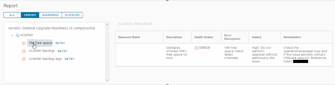

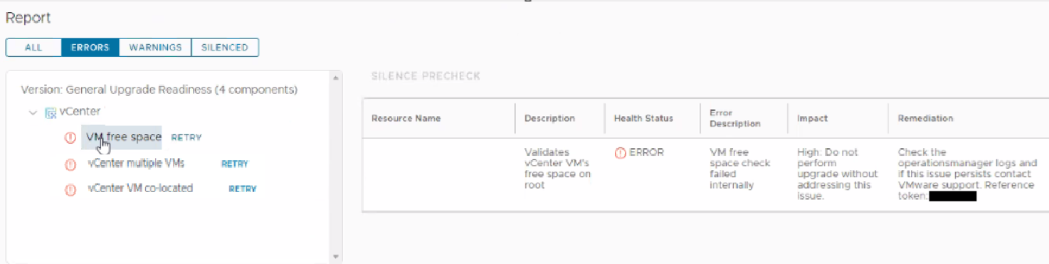

  • From the SDDC Manager UI Updates tab for a domain, vCenter Pre-check errors may be present, including:
    • VM free space
    • vCenter multiple VMs
    • vCenter co-located
