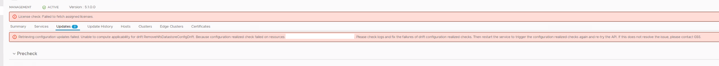

Ensure there are no errors or warnings on the workload. Otherwise those need to be resolved before running the precheck. Validate the licenses are correctly assigned and that there is no alarm shown. For example, if the UI displays
License check: Failed to fetch assigned Licenses.
and/or
Retrieving configuration updates failed. Unable to compute applicability for drift RemoveNfsDatastoreConfigDrift. Because configuration realized check failed on resources [########-####-####-####-############]. Please check logs and fix the failures of drift configuration realized checks. Then restart the service to trigger the configuration realized checks again and re-try the API. If this does not resolve the issue, please contact GSS.
like in the image below, resolve those first:
