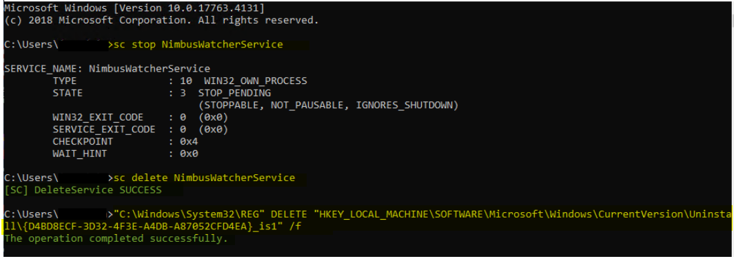

  • If the robot was installed differently (e.g., via native installer, or with Automated robot install) (64bit robot, Typically installed in C:\Program Files\Nimsoft) execute the following commands:
sc stop NimbusWatcherService
sc delete NimbusWatcherService
"C:\Windows\System32\REG" DELETE "HKEY_LOCAL_MACHINE\SOFTWARE\Microsoft\Windows\CurrentVersion\Uninstall\{D4BD8ECF-3D32-4F3E-A4DB-A87052CFD4EA}_is1" /f
rmdir /s /q <UIM_INSTALL_FOLDER>
--(Eg:rmdir /s /q  "C:\Program Files\Nimsoft")

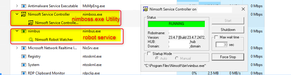

In the scenario where the  "nimsoft service controller" UI utility service tool (nimboss.exe) is running while the uninstallation is executed, the uninstall actually succeeds, however, the uninstaller, is not designed to suppress (shut down) the nimboss.exe. which is not the robot.
The nimboss.exe is not the Nimsoft Service (robot service) which is instead "nimbus.exe"
nimboss.exe is the "nimsoft service controller" UI utility service tool only. If it's in use, the silent uninstaller simply skip it as it cannot kill it. And leaves the folder structure up to it's location /nimsoft/bin
Normally, nimboss.exe, is not started by default in robots unless is manually started:
"Lunched" from programs: eg:
If it's started, and the "unins000.exe /SILENT /VERYSILENT /SUPPRESSMSGBOXES"  command is executed, the Robot (service, registry key and folder structure except for the utility nimboss.exe) is uninstalled correctly. while nimboss.exe remains.
If you believe you can run into scenarios where nimboss.exe is running on servers, ensure nimboss.exe is killed before running the uninstaller.
