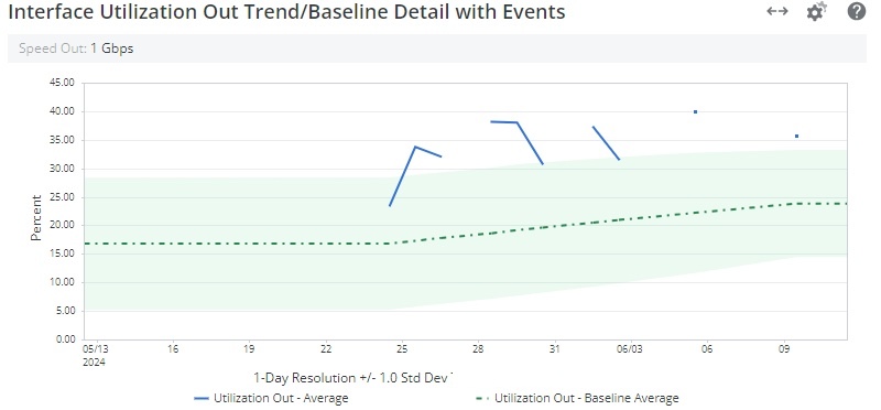

This results in data gaps in some dashboards as the related poll data is unable to be processed:
