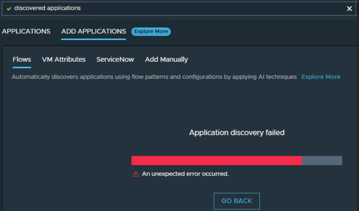

When attempting to use the Application Discovery Feature and choosing the "Add Applications" option, the error "An unexpected error occurred" displays on the screen.

  9. Navigate back to GUI and re-run query discovered applications, it should process it and error shouldn't be seen, Application Discovery Feature should work as expected.
