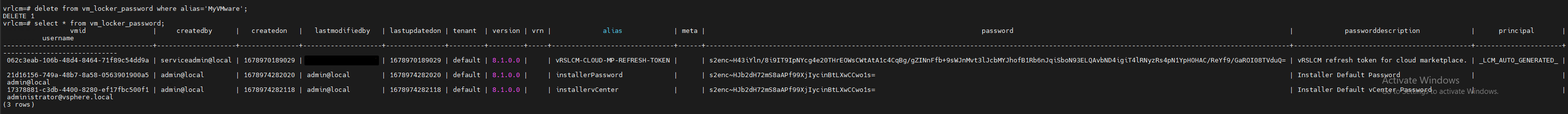

4. Locate the "vm_locker_password" from the list of database tables.
5. Run the below command to retrieve the data from the "vm_locker_password" table and locate the MyVMware credential Alias from the list.
select * from vm_locker_password;
6. Run the below command to confirm the correct credential gets displayed.
select * from vm_locker_password where alias='<alias-of-MyVMware password>';
7. Run the below command to delete the "MyVMware" credential from the database.
delete from vm_locker_password where alias='<alias-of-MyVMware password>';
8. Run the below command to disconnect from postgres.
\q
9. Login to the Aria Suite Lifecycle Manager user interface and reload the Locker >> Password page and validate if the MyVMware credential got deleted.
