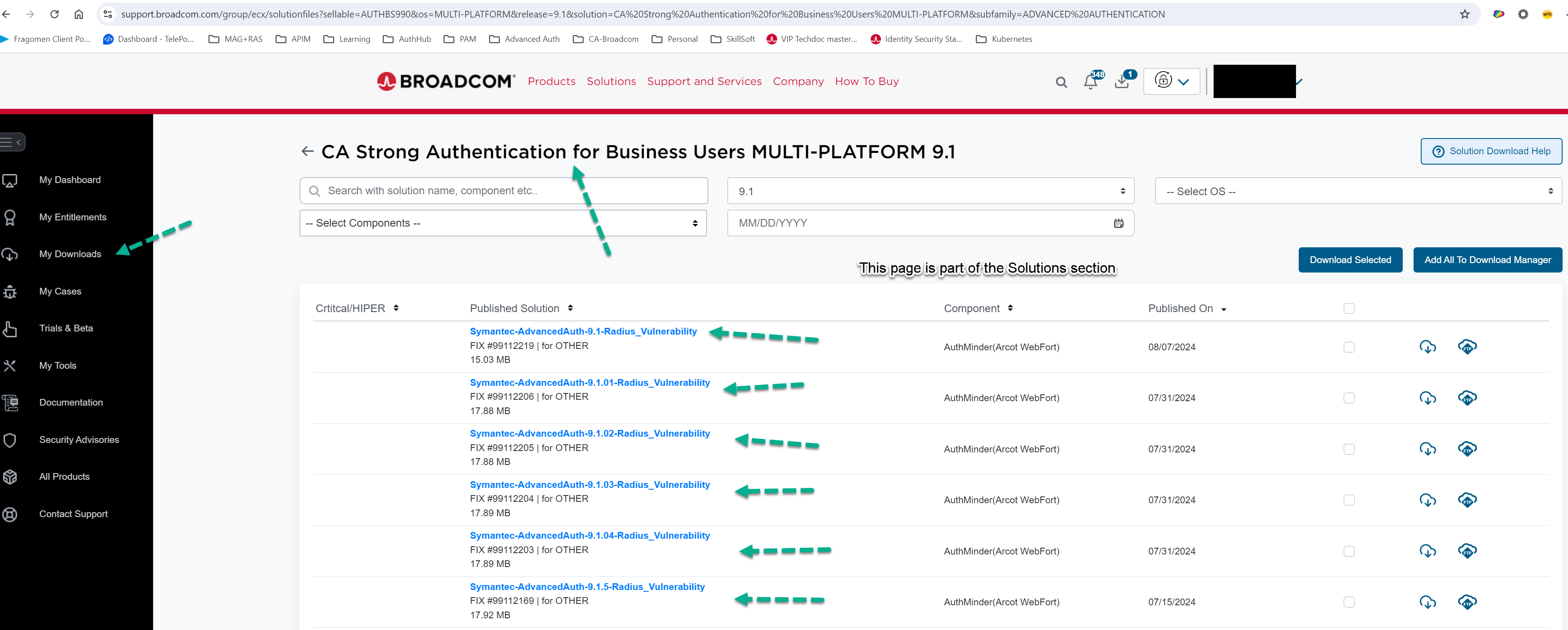

Hot fix Plan:
Hotfix for all 9.1.x Strong Authentication version is available to download from the support portal.
