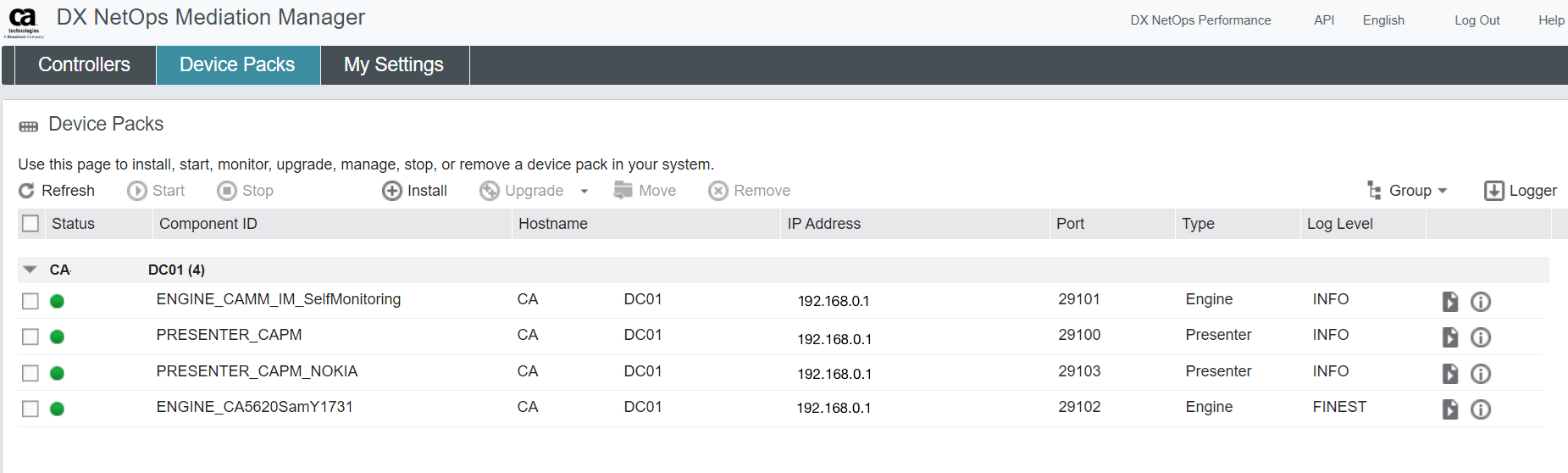

After installing a device pack, status seems to be online and working:
However, the system is not able to retrieve inventory and data from the device.
