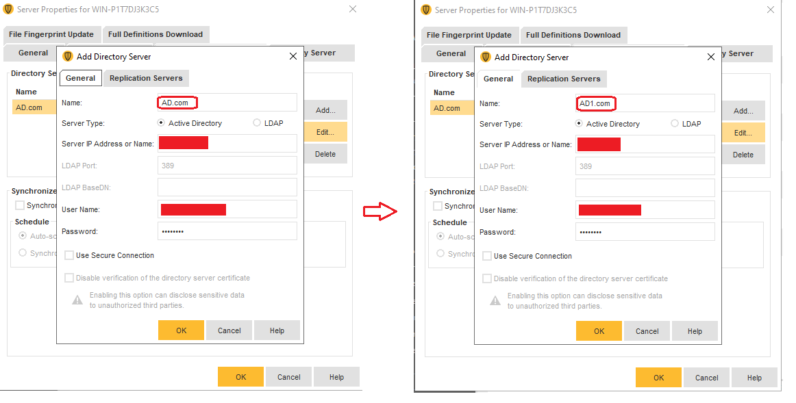

When using Directory Server Authentication, after changing the name of an already mapped Directory Server under Server Properties > Directory Servers, users mapped to that directory server won't be able to logon again if account is not remapped to renamed Directory.

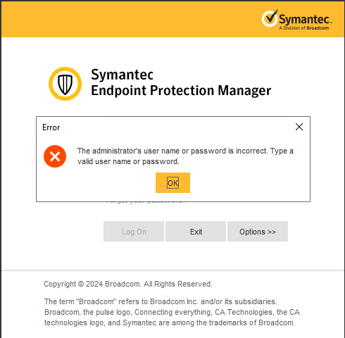

When logging to SEPM invalid credentials message will be displayed.
This can have a bigger impact if no other system admin account with local SEPM authentication or connected to another directory server exist.
After renaming the Directory Server, users are not automatically mapped to the renamed Directory server.
For example, after renaming the Directory Server from AD.com to AD1.com, an admin account will still be linked to AD.com instead of AD1.com.
Do not rename the Directory Servers using the Server properties dialog box, or else you won't be able to log on to the management server using administrators based on AD authentication. Instead, rename and remap the server's name for each administrator from the Administrator properties under authentication settings tab.
If the name of a Directory Server is changed in the Server properties dialog box, each admin linked to it must be remapped to the renamed Directory without logging off or by logging into SEPM using a system admin account.
Otherwise, access to SEPM can be lost, and it can only be recovered by restoring the database from a previous backup.
