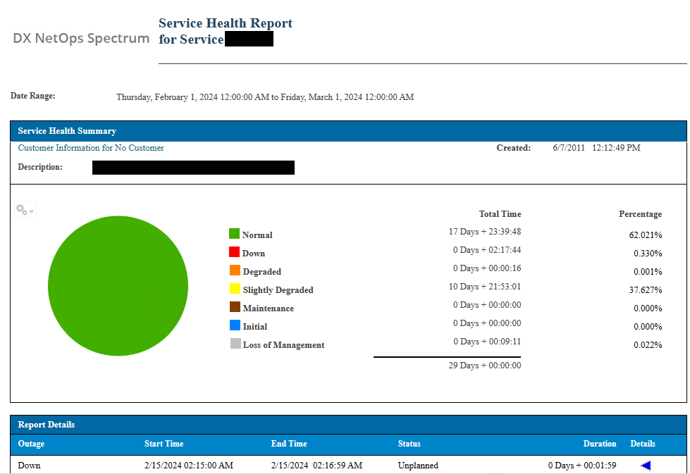

The Service Health Report pie chart shows as 100% Normal, but it is actually 62.201% Normal and 37.627% Slightly Degraded.
1/3 of the pie should be yellow (37.627%)
Other Service Manager reports show their pie chart accurately.
The issue has occurred since upgrading from CABI/JasperReports 6.4.3 to 7.9.2.
CABI/JasperReports 7.9.2
Data serial number flaw.
The fix will be delivered through DX NetOps Spectrum 23.3.12 (should be released by the end of July or early August).
